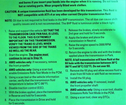

Clue me in,what issues are you having with your 8 speed.Have you done a service on the transmission,and followed these directions to a T,don't try scimping or short changing the instructions,follow them exactly,including the one about leveling the transmission,not the truck.
