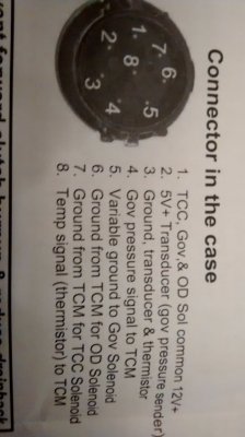

rowdyram
Feb 6, 2014
504
219
1996
magnum 5.9
This is a image for fwd but same sensor
