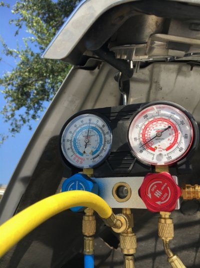

My a/c blows cold at highway speeds but warm when I stop in traffic.
I hooked manifold gauges to it and High and low sides are both around 60 as you can see in picture.
Condenser is clean and fan is blowing good.

Your high side is really low. Like the condenser isn't doing it's job or you could be low on Freon.
Look at this video. He's "topping off" his AC but he started with cold air. His high side is much higher. I'd wait for others feedback but you've got something not doing it's job sitting there.

If the high and low side pressures are the same when idling and the compressor is running, there is something wrong with the compressor, maybe a wasted discharge valve. It's possible an issue with the metering device but unlikely? What happens with the pressures at 2K rpms?
If the condenser wasn't doing it's job, the high side would be excessively high, not low.

What should I check next?

That high is way too low, either you have a clog in the system somewhere, or the compressor is on its way out. Im going to go with compressor, they are relatively cheap, and easy to replace.
if the fan isnt running full power with the AC on this could also cause this issue.

It turns out that I was doing something wrong with gauges. I hooked it back up to check again and it was a little low on refrigerant. I added a little more and it is cooling about 40 degrees cooler than ambient temperature. I must have made a stupid mistake
I think you did your test with engine and/or compressor off. When the compressor is not working, both low and high side will equalize and display the same pressure.
