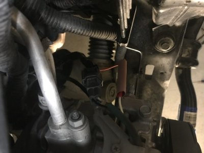

Las Vegas NV
When you say the compressor is spinning do you mean the clutch is engaging? If so may be an internal compressor issue. If not check voltage at the plug. If no voltage at the plug face try back probing it. Had a similar issue this weekend, replaced a melted clutch but it wouldn’t engage. Found voltage pin in connnecter bad ( blue/green wire) ended up just jumpering over the plug. Someone else on here had a similar issue too.
