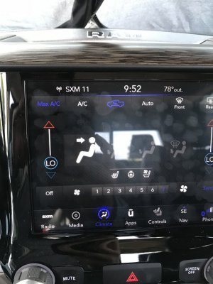

30017E3B-9C45-40D5-A0A4-4EEDD5F3EC2D.jpeg LOL, I just found the Max AC setting in uconnect. All this time I've only been using the manual knobs. There is no max a/c on the knobs.
