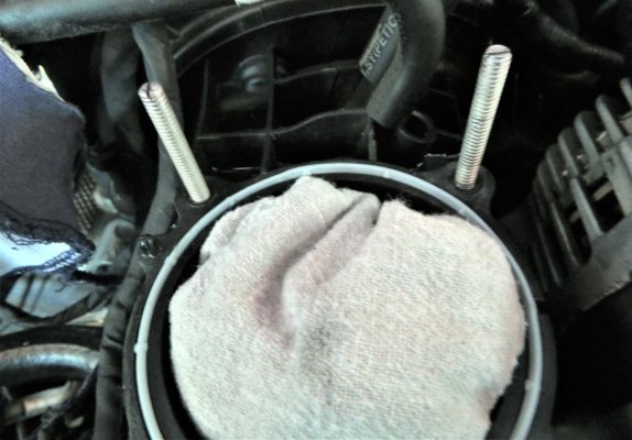

Give up on that throttle body.Odds are unless you're boosted or running a big cube stroker kit with ported heads/big cam/lots of rpm etc.,you don't need an aftermarket throttle body anyways.If you're just a cammed/bolt on 5.7,you'll be better off with the stock TB,especially if you haven't ported your intake manifold.Even if you do manage to get it mounted,there's a good chance you'll never get it to run right.But on the good side,you have a neat paperweight for the coffee table.A little reseach would of told you not to buy it,lol. If you're hung up on a bigger throttle body hit Dan up at Fastman,as he used to have the earlier TB's in ported sizes
Bolts aren't the way to go either,you want to do studs. 1/4" ready rod makes for a good throttle body stud to repair stripped out manifold holes
