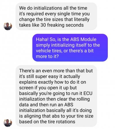

The install itself was easy; 4 hex bolts.
The AlfaOBD steps were easy, too; I had John Lance (from the AlfaOBD Group on FB) walk me through it, step-by-step. I will attach screenshots of our convo (because for the life of me, I can't verbalize it well enough to instruct the process) but it involved a few quick steps through AlfaOBD and a step using a basic scan program (I used the MX+ Scan app that came with my OBD dongle) to rescan all the modules at once, and clear any codes. Programming the ABS Module was easy for sure; just running AlfaOBD to recognize and initialize the VIN of the replacement module, then calibrating the tire size (after the "clear rolling data" command). If anything, reach out to John Lance on FB...he's awesome!
