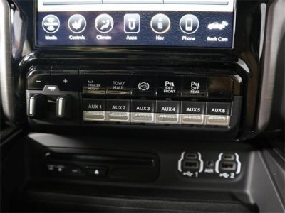

Thanks olyelr, is this an OEM part? My 2020 does not have those. Any help will be appreciated
yes, that is an oem setup. Not all trucks have it... but its an option on some. Im sure with some work, you could buy the switch and use it for accessories.

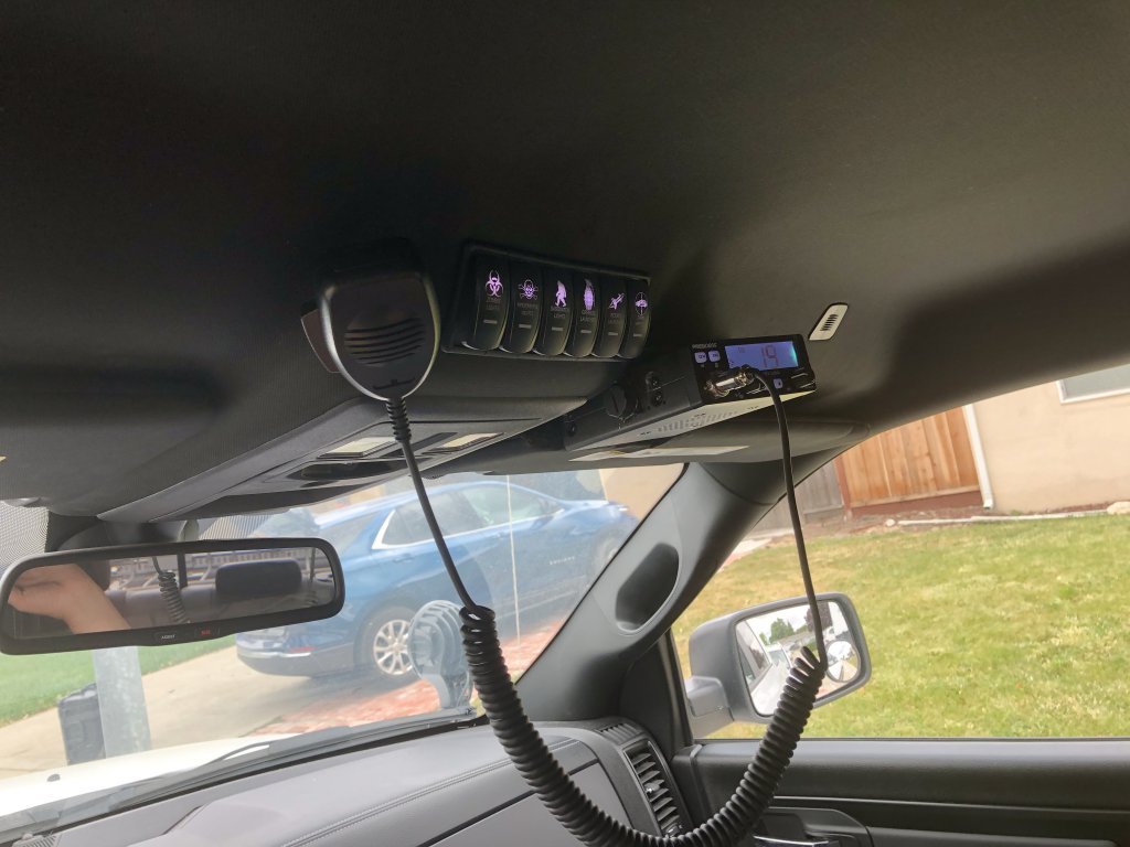

Mine is a 2018, so I know that’s not much help.... but I put my Aux switches in the headliner
I know not much help with a 2018 and no sunroof, but at least you can get an idea of what it might look like
