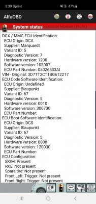

I have a 2011 2500 ST and would like to be able to unlock/lock my doors with a fob. I have AlphaObd and can change the settings to enable the feature. Would I need any modules, wiring harness, etc? Links to write-ups/parts would be much appreciated.
Do you currently have power door locks? With AlfaOBD, if you connect to the wireless ignition module and read the system status, what is the part number?

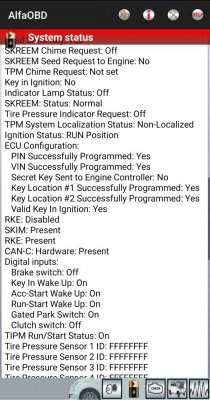

Has power locks and windows. Here are screenshots. Looks to me as if they were once programmed.

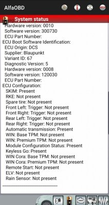

It doesn't show a PN for the module. Only the software and hardware version. I ran the ID test and PN is still blank.
