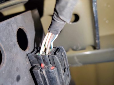

One question would be the connector needed for the front sensors to the module. I would think it requires more connectors with 6 sensors. What connector kit would be required for the front?

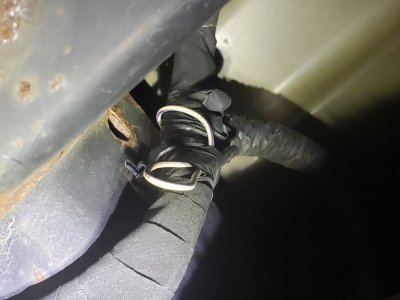

In the drivers side kick panel where I've installed the module, I do not currently have a wiring harness, but noted that there looks to be some kind of CANbus connections above it. Do I tie into this or is it located elsewhere?
Also, the wiring harness on the front bumper, if I understand correctly, I'll need to create my own harness to go from the driver side front bumper (next to where I put the harness for the fog lights) and run it through the firewall to one of the connectors on the parksense module itself, correct?
