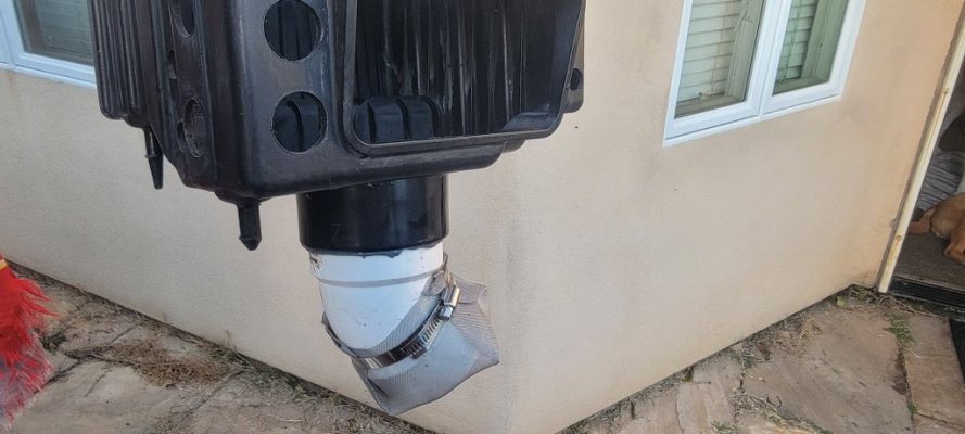

I was careful to make sure the whole was cut so it was a tight fit. I did put some more holes in the side of the airbox with the oem opening as well as a couple in the rear of the box. This allowed more air with out sucking in warm air or debris. Pointed the elbow towards the front of the truck so that it has a better ability to get the cool fresh air.
I used some 40 stainless steel mesh with a hose clamp to cover the opening to prevent debris from making it up into the box. Best part of this mod is that if you are in harsh conditions such as COLD, DUSTY, WATER CROSSINGS you can screw the cap that comes with the kit in to seal off the intake. I hope this helps others to make their trucks better.

It appears you have holes in the air box. If so you need to seal the air box.
Think of it this way. The air is going into the box from your tube and takes the path of least resistance which is out the holes, not through the filter. Also, that mesh is slowing down the air flow. If you have a filter, you don't need the mesh.
The best you can hope for is this when you plug up the holes and remove the mesh: You are driving down the highway and the force of the air increases the air pressure in the box and a bit more air gets into the engine.
The second best you can hope for after you plug the holes is that the air getting into the box is a bit cooler then the factory set up.

I can say the truck runs great. Runs cooler and with more power. While coming back into San Diego from Yuma pulling a small dump trailer, I was able to run up the hills and stay in 6th gear. The truck has more power. It is able to keep pulling instead of dropping rpms and losing power. I have gotten over 1 mpg better on my trip to Arkansas, but I did do the Spyntec free spin hub upgrade at the same time. Both are great upgrades and I highly recommend.

And you got the tail wind by going west to east.
