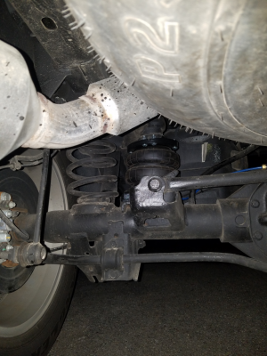

The Timber Grove ASAMs might be a little bit better priced than the Loadlifter 5000's. I have the ASAMs and the WirelessOne running together with no issues.

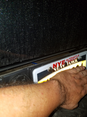

I ran the air fill line through the license plate bolt hole. I ran the WirelessOne air fill line to a quick connect T-fitting supplied with the WirelessOne kit, and spliced it in to the rear fill air line.

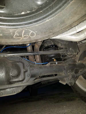

I placed the WirelessOne compressor and manifold on the frame below the driver's door. It was easy enough to do. It's a toss up of what I want to do next....CAI or Hellwig...or something else. I need to stop spending money on this for a bit....LOL
