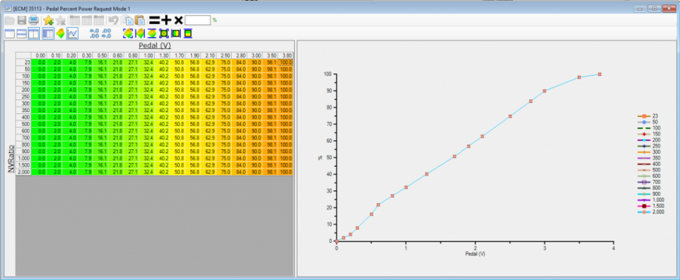

yea that stock pedal is lazy and just as i figured it step changes from lazy to open- i hate that

just for fun i copied over the third one in your pics truck is underivable man haha lol.. as soon as i touch the pedal it jumps had to turn back reinstall previous tune.. :)

Oppps my bad yesterday i inputed 70 instead of 7 2nd column lol .. fixed

Adding my setup here since thread helped me out a lot. I decided to mellow out how linear the start of the pedal was and ramp up quick so it feels better when you get on it but moves into the power smoother. It doesn't have that quick seat kickback that wants to break lose the tires.

Quick update, the above values were too aggressive and slow, this seems to work better.
