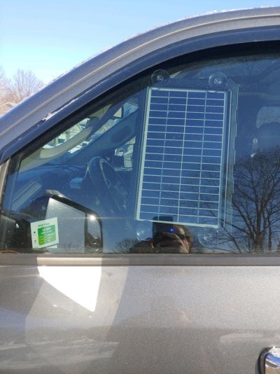

My 2013 OEM Batteries lasted 3.5 years, My deka AGM are Now 8+ years old, Now that being said the truck sits for 10+ days during much of the winter months, if you don't add some type of continuous charging they will fail in XXs months, the picture below is my old 12w solar charger, I have change it to 21w now.
