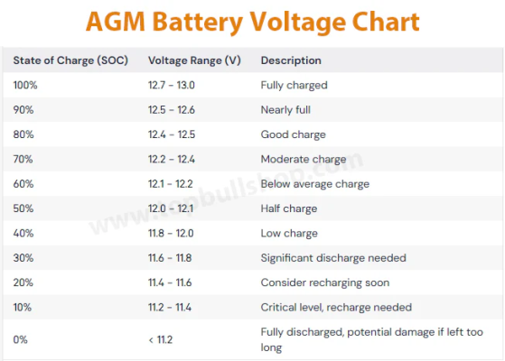

Read this,
I love AGM batteries. When Harley-Davidson put them as OE in 1997, it took care of a variety of issues, including frame damage from acid leaks. But they require a different charger. Note the difference between 80 percent and 100. I am pretty positive that
our charging systems cannot maintain that level. Even worse, if it goes dead it will need to go on an AGM charger to get it back to that level. For the time being, I will stick with flooded batteries. Oh and DEKA makes H-D batteries. Good product!
Just my 2 cents.
