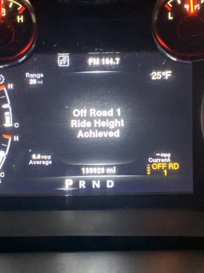

I forgot to post an update on the 2013, I’v been a professional trucker for over 20 years and we always use airline dryer during cold months. I removed my right rear taillight, pulled out the two lines and filled both with airline dryer. I found it was just the compressor freezing up.I bought a small 12V blanket heater on Amazon for $20. Works good It’s been pretty cold here in northern Maine, about 20-30 degrees, I have had no issues at al since. I just picked up a brand new complete air suspension for $400. A guy I met just bought a 2014 and the dealership replaced the complete system with a new one. He took it all out and replaced it with a 4” lift. Thanks for the help.
