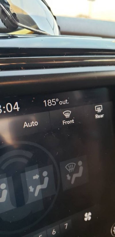

Anyone possibly know what setting I changed. I am getting ambient temp sensor error with check engine light. 2c397de68115daf3ac7211d2a14c7eff.jpg
What year are the mirrors you installed? They need to be for a 13 or newer for the temp sensor.
Jkieffer
Jun 1, 2017
319
128
They Are toow mirrors of 2015 and everything was working until I put the smart beam mirror in with humidity sensor in. I set something un the settings by mistake I can't find.
Ricks Ram
May 1, 2015
4,411
3,415
Sorry just remembered you said they were off a 14. First thing I would reccomend is check to make sure the temp sensor is on the drivers side mirror if it is then you either have a problem with the temp sensor on the mirror or you somehow changed a code. First thing I would reccomend is check the mirror for a temp sensor. If it doesn't have one that's your problem. If it does have one I would reccomend installing your old drivers side mirror and see if it helps. If it does it's the mirror if it doesn't it is most likely something you changed.
Ricks Ram
May 1, 2015
4,411
3,415
Then you most likely changed the temp sensor location. Did you notate all if your changes? You most likely made a change to the outside mirror instead of the rearview mirror with the tool.
Ricks Ram
May 1, 2015
4,411
3,415
Did you set the code for the humidity sensor?
Jkieffer
Jun 1, 2017
319
128
That's what I was attempting to change then I read and it said that it did not have to be set.
Ricks Ram
May 1, 2015
4,411
3,415
Uou are correct that doesn't need to be set.
