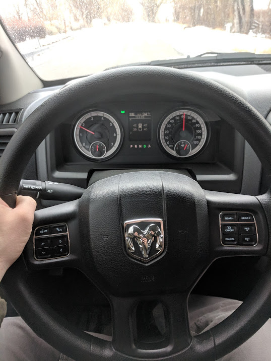

In addition, when driving straight, the wheel is ever so slightly turned to the left. With no driver input, the truck seems to veer right a little, but I haven't found a great road without crowning to really test.

The steering is prob crooked because the tech was in a rush and didn't center the steering properly. since he has to readjust to fix his job, mind as well telling the dude to redo the camber, anywhere between -0.2 to 0, if both can be -0.2 even better.
