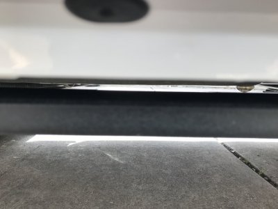

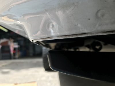

Mine aren’t hanging up, check out the pic, it’s at least 7/8 of an inch from clearing the pinch weld. Bouncing on them will not move them an inch, it may move them an 1/8” but no way it will move the amount I need.

I appreciate everyone trying to help but “bouncing” on the steps is not going to move these as much as is needed. The passenger side overlaps the pinch weld by a full 1/2” so it needs to go back that half inch, plus the distance of the rain gutter 3/8”. So if you really mean to tell me to bounce on them to move them an inch I think your dreaming.

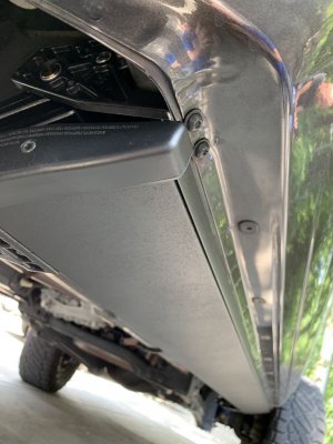

Look at the difference in the two sides
Drivers Side (hangs on pinch weld even after bounce trick)
Passenger side (over lap pinch weld 1/2”)

I wasn’t thinking you were messing with me, it’s hard to describe, the pics show it much better. I did do the installation, I’ve been working on cars/trucks for years. Hell I did a Fab-tech 6” lift on a 2019 1500 with IFS just a couple months ago, that’s much much more involved than these steps. There is no way that 12 bolts on Amp steps are that hard to install. There has to be something wrong, it’s not like they are off a little, they are off a mile.

Yeah, I’m at a loss how the two sides can be so different. I had the same thought you can’t really screw up the installation, I would think that they should just fit and if they needed a tweak here or there you use the bounce method but the difference between my drivers side and passenger side is 1 1/2”. I’ll call Amp tomorrow and see what they say
