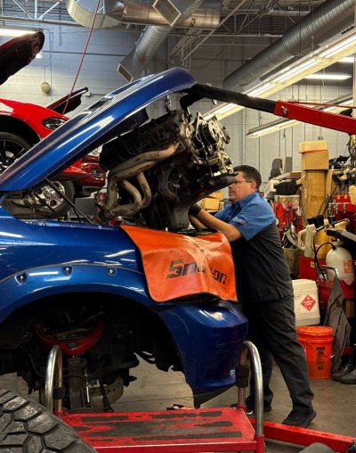

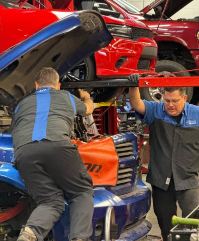

Its been awhile since I had anything to post but recently had a misfire occur on my 5.7 hemi at 171,000. The engine would smoke at start up. It would clear up after warm up but misfire it idle. Not having unusual noises in the engine bay per say led me to drive the truck further but the misfire continued to get worse. It would pop p300 occasionally.
Brought the truck to a long time friend of mine at Larry H. Miller service department. After diagnosis turns out my #1 spark plug electrode broke off and did a happy dance scouring the cylinder wall.
Left at a cross roads a reman 5.7 was the same cost from the dealer as MMX 6.4L SRT Engine. Doing my research I opted for the 6.4L MMX route.
List of items ordered:
MMX 6.4L SRT Engine
MMX 6.4L truck stroker oil pan gasket
MMX 6.4L truck intake manifold with SRV harness extension and 6.4L injectors

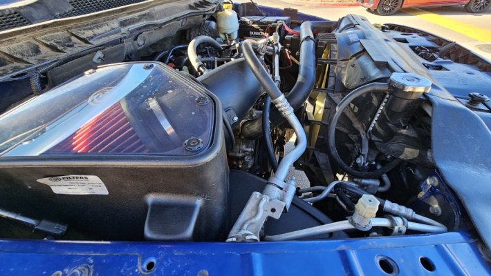

S&B 6.4L truck CAI
Since Jay Greene has done all my Ram tuning he was my guy to get this truck running with the 5.7 PCM and TCM tuning.
MODS that moved over:
AFE 1 3/4 long tubes w cats
Hellcat TB
4.56 Rear gear
It was admitted to me after the install that the mechanics were skeptical that this would work at all since this is a one off request. They had not seen this engine running in a ram 1500.
With over 1000 miles clocked on the odometer the swap has been a complete success. No Cel no issues.
The TQ over the 5.7 is awesome to say the least. Typical increases are 30-50lbs of tq at lower rpms.

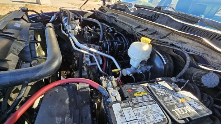

Im trying to get photos to post but it's giving me issues so I'll try in another post.

My only issue left is oil temp. My truck didn't include the factory oil/water cooler like some of the newer trucks. Street driving is fine but freeway driving makes me a bit nervous. Temps will get up to 235.
I have the factory parts priced out just waiting for them to arrive to install. If that's not enough I'll go the Improved racing route with the oil sandwich plate, lines and cooler.

Here's the engine:
It's basically a complete no-brainer to go with something like this, versus rebuilding a grenaded 5.7L. Heck, I'm tempted to do it just because, haha..... but my current engine (5.7L) is running pretty much perfect.
I really did want the cam version but I was afraid of CEL issues. I have to pass OB2 inspections every other year and that CEL light cannot be on for any reason to pass. Saved some money but if you didn't have to worry about inspection definitely a perfect time to add that cam to the build.
