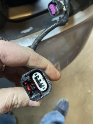

So, more frustration...
my AlphaRex Pro series G2’s arrived this week. I’ve had the hikari H7’s on the bench waiting for a while. Out of the box, I can only get the low beam to work on the driver side. Reversing the polarity on the high beam didn’t help. I didn’t try the passenger side, because I also figured out the turn signal connectors are a mismatch. The New housings would plug into the old 9157(?) socket except I don’t have a 9157 socket. I’ve got a different 3-wire flat connector on the truck side.
Has anybody else installed these housings on a 2019+ classic? Is there an adapter harness ojt there? Am I missing something?

Can you take pic's of what you are describing. It'll be easier pointing out what's what

Yeah, about halfway through typing. I realized I was really just complaining without pics.circled in red is the 9157 socket that alpharex says to plug their turn signal connector into. The other pic below is what unplugged from the turn signals on the factory housing.
After I put my truck back together and drove it to dinner, I started to wonder if I unplugged the connector from the socket when I should have twisted the socket out of the housing instead. Think I’ll head out to the garage and take it apart again and look at that.
yep. That was the issue. I swear, if my mother hadn’t had me tested, I’d wonder if my elevator went all the way to the top.
