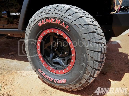

Ok Guys, I need to pick your all's brain one more time. I already ordered the tires I actually changed my mind and went with the General Grabbers. I went with the 35x12.5
I'm getting ready to order the wheels Which I want to go with. They are:
KMC XD125 17 X 9, 5X5.5 OS: 0mm BS: 5.00"
Should I be okay with this combo? I'm thinking of coating the faux beadlock ring red to match the tires. Thoughts?

Ok So everything is ordered. Hopefully the wheels fit, I did end up ordering The KMC XD Endura's 125 and the Grabbers. Hopefully everything comes in this next week. I also ordered a set of the Skyjacker M95 Shocks. Anyone have any experience with these?
