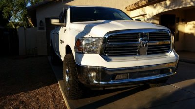

I'm running the CST kit 4" front spindle, 1.5" rear spacer. It's a 1500 2wd crew cab. Just installed 35 1250 20 mt baja mtz. No rubbing or anything.
So far best investment I've made.

Just had my 4.5" spindle/1.5" rear done this week. Factory 20's on 295/65/20 (35.4") trail grapplers. Looks great, couldn't be happier and absolutely NO rubbing!!
