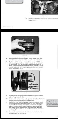

Are all 6" kits like this or just ones that have this preload spacer? (Pic included to confirm my comprehension)
Wouldn't the 4" Zone suspension kit + bils at ~2.1 provide the same overall 6" height I'd get from the 6" + bils at 0?(albeit less flexibility in adding height)Screenshot_20181008-145827_Google PDF Viewer.jpeg
Sent from my SM-G965U1 using Tapatalk

Not all lifts use the pre-load spacer. With the Zone 4" lift they provide 2" rear coil spacers. if you upgrade to the 3" coil springs its a $77 upgrade which makes it the same price as the 6". A lot of guys are running zone or bds (Both owned by fox so very similar) because they are very flexible and don't leave you stuck.
What are your fender measurements now? Measured from the ground to the top of the wheel arch
Then tell me where you want it to sit and I will explain the math to you if that helps
Got it. My truck is in the shop because the CJDR dealer forgot to put my lug nuts back on and my front end collapsed(pic also attached for humor). Once I get it back, i can provide measurements.
So the 4" kit wouldn't work because I already have the spacer... makes sense.
