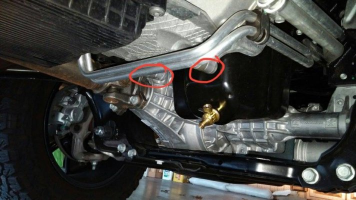

bassheadhemi
Apr 18, 2015
1,031
411
Montreal, Canada
How did you lift the engine from that side? I can find the motor mount, np.
Thanks much, Basshead!
I'll be honest, I've used a piece of 4x4 between the jack and... can't remember. I'm pretty it's not the oil pan as I have a oil heater on it and that would have damage the heater.
I'll try to find a picture to help my memory
bassheadhemi
Apr 18, 2015
1,031
411
Montreal, Canada
Found a picture on the web, I think the 4x4 was where the 2 red circles are. Being attached on the passenger side, the driver side came up without problem. f0c9e0fdf3bc04d5f81044bdf01c13a9.jpg
Sent from my SM-N950W using Tapatalk

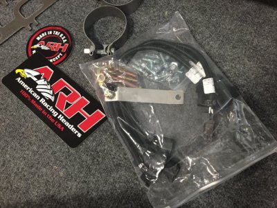

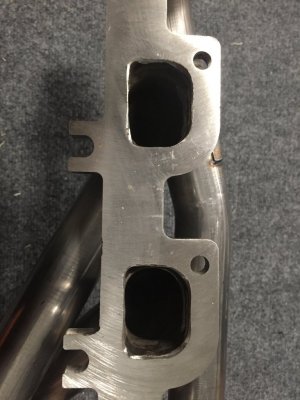

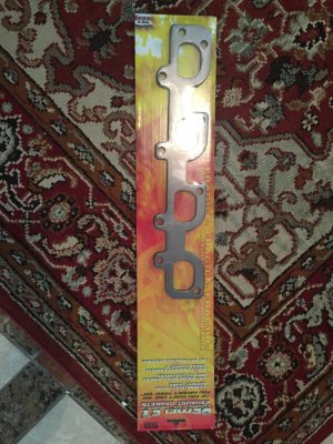

Out of the box pics

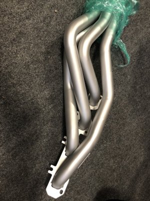

Stage 8 fasteners and a peek at the ceramic coating. I think they came out great.
