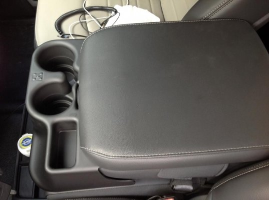

I ended up ordering this one: Dodge Ram Cup Holder for '03-'05, '06-'09 Non-Sport trucks.-Geno's Garage
It showed up today and I just installed it according to the directions. It was a pretty straight forward install but still wouldn't latch, even after I shimmed the latch as recommended. I ended up removing some material from the cup holder around the latch release handle and that did the trick.
Not as nice as a factory unit but better than any other aftermarket options I could find. I'm pleased with it.
