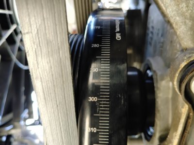

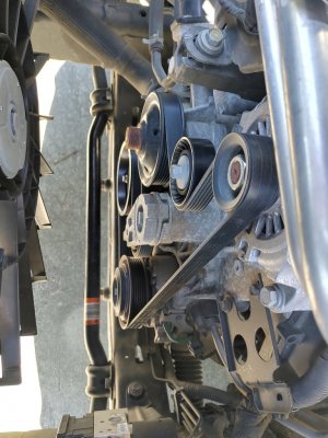

Yes i tightened down with the old bolt then replaced with new one. Seated? Im not quite sure what that exactly is. Ill take a picture if you dont mind looking at it? Right now its even with the other spindles and the belt is on. Engine turns over and cranks but there is a whistling sound coming from the new damper.

By seated I mean the inside shoulder of the dampener where the bolt/washer sit will be flush with the end of the crankshaft.You're good to go if everything is lined up and the bolt is torqued to spec.Start it up and drive it around for a bit,and see if it's still making a whistling sound
