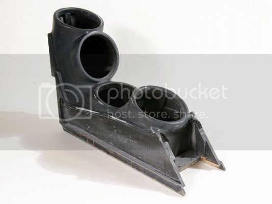

I am cutting up my back seat, turning them into two full buckets. The subs will be in a custom center console running from the back seat to the fronts.
wermbang
Jun 29, 2010
9,724
215
Iowa
2001 Off Road
5.9L V8 Sport
So something like this but with 5
