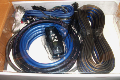

Bought a few more items today, unfortunately the DSR1 and the AR-CH2 harness are on back order :wtf2:
but got the extension cable so I can mount the DSR1 in the back of the truck and also got that JL Distribution Block
I am hoping winter will be over by the time I round all this stuff up, :eek:
Here is some of the stuff :waytogo:
