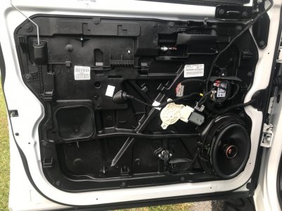

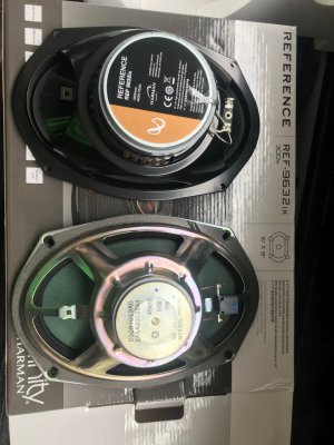

For the front doors the tiny little 6x9's from the factory fit great but your average 6x9 is just a little proud for the factory space. Good rule of thumb is 3" or more depth and your gonna have problems. Now here's the good part a 1/4" spacer and your good.
Luckily for me I already knew the Infinty's came with a spacer for bottom mounting them, a little extra foam tape to help seal the spacer and speaker to the door panel and I repurposed them to get that little extra room to clear the window brakect.
Again I used a Metra harness this time it was a 72-6514, it's not needed as much on the door speaker but I like the fact I can plug it in and not butcher up the factory wires.

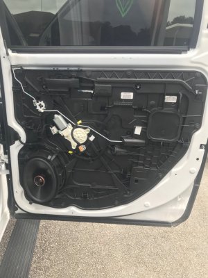

Last but not least the rear door speakers require nothing other than the 72-6514 harness. They just drop right in with no lube.
I used the screws that came with the speakers for install as the fronts needed longer ones and the head on the factory ones was right up against the rubber on the rear speakers. Since the speakers mount into the plastic door liner they just screwed right through. With a little persuasion.
