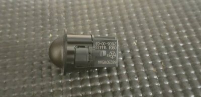

Definitely try covering the sensor with a towel and see if it works. The sensor itself is not expensive and it's easy to change. This is a picture of the one that came in my 14 Express. It should be the same part number as yours. Part# 68230115AA. I changed it because I added the automatic temperature control and they take a different suns sensor. If you change it just gently start prying up on the grill with something that is not going to scratch your dash and it will pop right off so you can get to the actual sensor.20181023_083741.jpeg20181023_083707.jpeg

Well, I ordered the $28.00 part at my local dodge dealer and replaced it this afternoon. Lights are working as expected now with the Auto function. It took all of a couple minutes to replace it. Thanks again for providing the part number and help.
