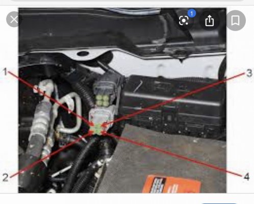

They aren't hooked up to anything by default. Look under the hood, driver's side towards the fire wall. You'll see to 4 slot connectors one dark Grey and one light Grey. The switches control them. If he bought it used he probably won't have the wiring pig tails for them. A dealer can order them if he plans on using them. You can program the switches through the evic (cluster) under commercial settings I believe. You can program them to be either to be "always on" no key needed, acc powered on and momentary if you wanted a air horn or something similar.
With mine I have one running lights on my headache rack, one running led cubes behind the grill, and one running some cheap rock lights attached to the hood as hood lights
Edit here's a pic of the connectors
I don't remember if the connectors are labeled but easiest way to figure out what is what is use a test light
