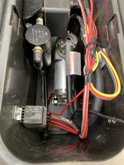

There has been at least one who mounted a small compressor in the bin behind the front seats and under floor. Also, there is room if you want to change out the stock intake for a Vara Ram, or Mopar Ram Air. That way the space previously used for the filter box becomes empty space and might be a good location for a compressor. Only other option might be in the bed, as under the hood is already pretty crowded.

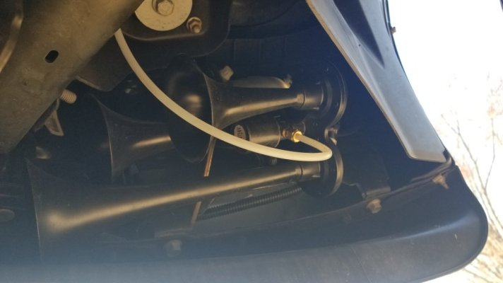

Check Kleinn for the air system (with or without air horns) as they offer a compressor and tank that bolts up behind the front bumper
I didn't see the behind bumper kit. Not much room with an intercooler. Is that for a gasser truck? They offer some pricey stuff.
I fit my triples behind the right side front bumper. Was able to use an existing bolt too. And it's easily accessible and serviceable for the solenoid. The pic is from the ground looking up. I know, another crappy pic. Lol.

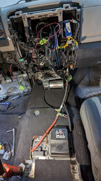

Good info. Thanks. Did you have to remove the bed to do this install?
He cheated....he made a whole new flatbed then re-did that to extend it after a recent huntin trip....lol(pic kinda looks familiar)
But if he says you can fit whatever in there..you probably can.
