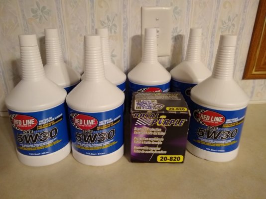

Avoiding the HEMI tick? ... hopefully.
Red Line 5w/30 and a Royal Purple 20-820 oil filter is my strategy and hopefully will keep the possibility of the cam/lifters from imploding in my 2017 HEMI.
I'm prepared for the next and upcoming oil/filter change. I'm currently on my second run using this oil/filter combo and am happy with the results.
