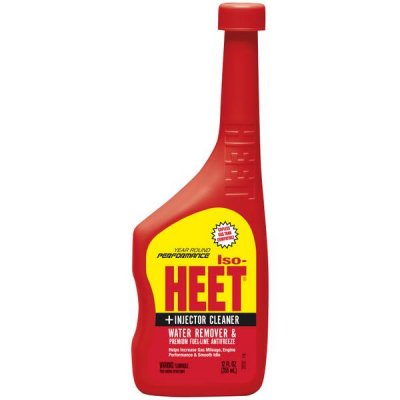

Put in a few gallons of the highest premium gas in your area
There is a product that is suppose to help get rid of water in gas, i don't know the name of it
This corn gas that they forced us to use, not only has a lot of water in it, it gums things up & corrodes metal.
That is the reason that all gas tanks are plastic now
