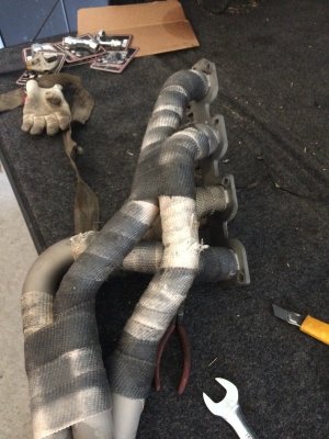

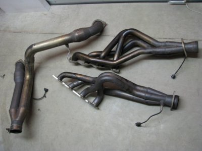

I've gone through all the different coatings and wraps on my truck for various reasons. The ARH heads I had coated ended up still transferring enough heat from my exhaust to melt wiring and plastic clips 2" away. I managed to catch a wiring harness of fire at one point because of how how the headers were getting. The coating also started to flake after 1 year from some of the joints because of the heat expansion with my system.
I have since wrapped the headers (what warranty, lol) but beware the header wrap you get. I thought the black header wrap would be awesome but they don't tell you that it can bleach out under heat and it looks like utter crap when that happens. Since I swapped all the wrap to the volcanic glass wrap they have held up beautifully for 3 years now. I have also had zero heat related issues with the harnesses and hoses around the headers since they were wrapped.
The last pic is the coated headers after 1 year of use

Nice job on the wrap....I had my coated inside and out and still look good about 2yrs now! Gotta do something for the additional heat.
