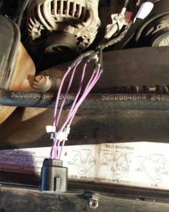

Ole Red responded very nicely to a 90mm throttle body install I did when using a Megsquirt tuner. I've found a BBK for the 05+ and need the newer electrical connector. Anyone have a spare or done a similar install?

Ordered a 05 plug, should have it Tuesday.

Pin-out indicate they are the same. Anyone have other information?

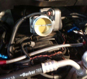

The new TB is installed and fired right up with good idle and no codes. The 05 TB is shorter than my 03 TB and I needed to make a spacer for it to fit and a taper to smooth the transition.
Edit: the picture of three TB are one standard and a FastMan 85 and then the BBK 90mm

I've wondered if it was as simple as changing the connector on the tb so us 03/04 guys can run the 05+ style.
I can confirm the plugs are wired the same. And the early connector will not fit the 05+ TB. I recommend just using the new plug spliced to the 03-04 harness, No Big Deal in my book...
