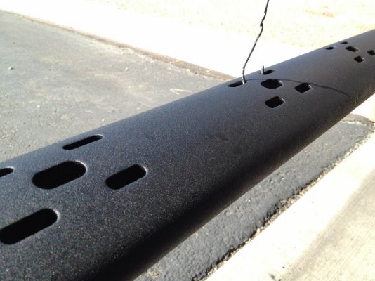

Anyone think I can make my step bars into black? Was gonna sell them to buy some black ones but if I can make them black myself that would be cheaper, easier and more fun!! So what kind of stuff did you all use?

I scuffed mine up with 800 grit sandpaper. Then I used Rustoleum bedliner in an aerosol can, several coats. Then I sprayed DupliColor Bed Armor, also aerosol, on top of it for the texture.

I wanna say like $30-$40. I think I used 3 cans of Rustoleum and less than one can of DupliColor.

For me it was easier to cover more area with the Rustoleum. And it sprays pretty evenly. I liked the texture of DupliColor better, so I just put a couple coats on top. It sprays out in kind of a splatter, so I think covering a large area with just it would be kind of hard. I got both of them at Advance Auto.

Until your arms feel like they're gonna fall off and then some more probably. If I had mine to do over I would sand a lot more than I did.
