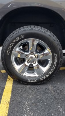

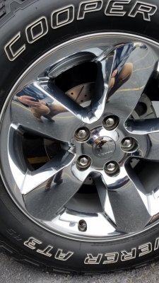

EC2BF44D-BED2-454F-98ED-522B56A1CE7D.jpeg Slotted rotors help keep an even flat surface on the pad. Gives pad debris a place to be deposited and swiped away. Drilled rotors main advantage is to dissipate heat rapidly. This is why you see most every real performance vehicle has some variation of the two or both. Lessens brake fade and maintains a faster ready braking ability.
9 times out of 10 they will outperform non-slotted/drilled rotors given same pad material. You will notice a firmer, more consistent braking.
They also look pretty badass behind your wheels.
