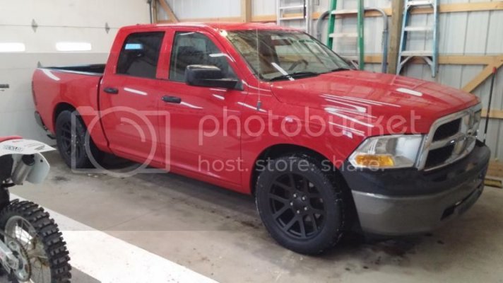

I got mine directly through Napa, their PN is 8271739. The spring is pretty universal but I haven't had any issues with a 4" drop. They suggest 5lb minimum to avoid pinching, I run 8lbs to be safe. It raised the rear about 1/4" . I actually like it because it gave the truck just the slightest rake. Here what it looks like with the McG kit and the bags installed.
Ps. I didn't see before that you don't plan to haul. If you don't at all, you probably don't have to have the air ride. For me, even loading my dirt bikes and gear (maybe 600lbs) started to squat it so I put them on so it's never sagging.
