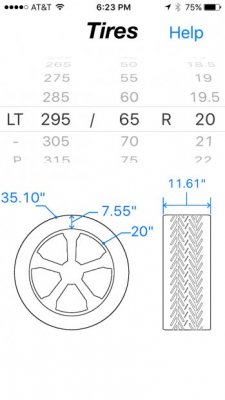

I'd suggest this size as the biggest to be safe if you're planning on keeping the factory wheels.. Even a 275/65/20 would be a good size also.
this size above is what I was going to go with on my 2" level until I decided to lift it.
