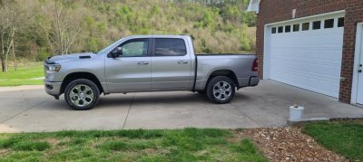

Bilstein 5100 installed up front
Rick_Hunts
Mar 15, 2021
101
23
TN
Really like the way she sits now, very have with the install, local shop did it for $250 including alignment.
They did say they had problems with the old shocks being rusted on the top bolt... anyway really like the look, to me no different ride.
Just got my (new to me) 2021 black 20" (Mopar) rims after a short trip next month going to replace stock tires with Toyo Open Country AT3 275.60.20

Looks nice .... Do you have the ORP and what setting did you go with ?

No ORP
Set to position 5 which is 1.7 inches

Did you replace the UCAs or keep them stock? I will eventually install the 5100s, but can't decide if i'm going to upgrade the UCAs at the same time.

Stock, did get an alignment though at the same time
