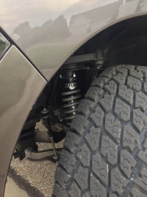

I chose the Fox and Zone UCA's and they ride fantastic. 50k truck, saw no reason to not do it right the first time. Plus Autoanything sold me the Fox for 383 apiece with free shipping. They are beautiful
