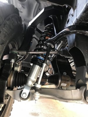

This is the route I’m definitely going to go once Shock Surplus gets them back in stock. Quick question. Does anyone have these installed at Circlip 7 which I believe is a 2.4” lift? And if so, did you do aftermarket UCA’s or just run with the factory ones.

UCA’s on anything above 2.5” is a good insurance policy. You’ll want the ones with angle correction readylift and zone UCA’s are both great options

Already have TuffTruck rear springs and have the Bilstein shocks I bought off a buddy of mine who never installed them. I’m planning on installing the shocks myself. I ordered those tools from Thuren Fab. Am I correct in assuming, because I couldn’t find a video, that with those you can just do the shocks with the rear tires and fender well in place as she sits on the ground?

yes removing the fender wells makes it easier but is not necessary. And you can do shocks on the ground. However you’ll be doing coils and shocks so you’ll need tall jack stands under the frame. I remove the rear tires to make dropping the rear easier to get the springs out.

BDS recommends UCAs around 2". I did Zone UCAs with just 2" couple of years ago now at 2.75 thinking to crank up my coilovers for 3" and they have been set it and forget it. You're getting a nice set of lifting struts seal the deal with aftermarket UCAs. You'll have not only piece of mind but more alignment correction after lift, better arms and better BJs.Cant go wrong with them with 2-3" lifts.

The 6112's are on national back order. IF you want to get a set best bet is to get an order in for them now as restocking orders are a ways out. There are many back orders already in. We can get them ordered up for you and have them drop shipped straight from Bilstein to you to minimize lead times. We can offer great pricing on them as well!
2"+ I recommend UCAs if you plan to off road. If it is a street driven truck then you can get away with a little more lift on stock UCA's up to about 2.5". Zone is a great option and would pair up nicely with the 6112's!

I had my 6112’s maxed and ran the zone control arms. I’ve had them for 3 years now with zero issues, I was the first member here to run them.

How was the ride with them set that high? Currently have a Zone 6 with 5100s at 2.1, but have a set of 6112 sitting in the garage to install. Debating if i want to go up one more notch or not when i do!

Rode fantastic, very smooth. The coil springs are great, much better than OEM
