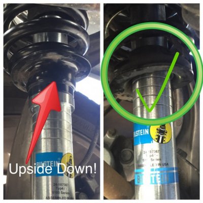

And just in case you decide to do the install while drinking....this picture is worth 2 hours.
LOL ! wow that would be like 5" lift LOL

Nah it wasn't that bad lol... But I was wondering what all the fuss is about the bilstiens.... I was like these ride like ****!! Then the next morning I took another look ;)
I'm installing mine on saturday. Thanks for the heads up, definitely something I would ***** drinking or not.
