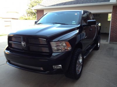

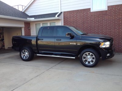

Finally installed. Took a few pictures. I will upload better ones later.

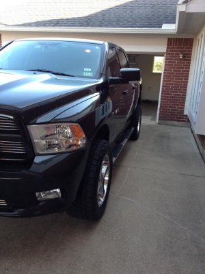

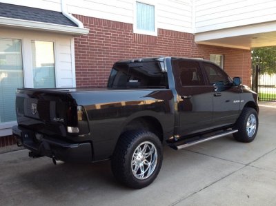

a few more pictures

Wow, nicely done! looks amazing! what size/offset are the rims? and what size tires? and did you get the shocks as well as the struts?

looks great!!! what offset are those wheels?

Yeah, I want to know also what size tires are those, I like it it look sick.

Here are the specs - fuel hostage 20 x 10 -12 offset, bilstein maxed out, 1.5" spacer in the rear, 305/55/20 nitto terra grapplers.
