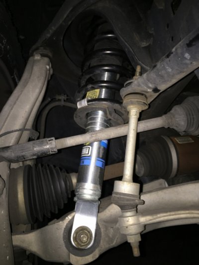

Tires and bilstein 5100's were put on today along with alignment. It's dark out now to take pictures. The bils are set at 2.1, felt great to drive. No issues on the way home and on the highway. Felt a little slower lol. I will take better pictures tomorrow in the day light. But here are some teaser shots even though you all know what they look like @ 2.1

Looks good but good lord those wheels are curbed to hell! Unless it was the tire shop then bring that back and ask for new wheels.

Watch those uca's like a hawk, the bilsteins will start pushing up on the balljoints and they can pop out. 2014-2015 rams are bad for.
this and most people have installed new mevotech uca's to prevent early ball joint failure, in ky area i cannot find a shop that will do my truck without replacement due to safety factor

Where can I look to keep a hawk eye on them so I can see if I have to replace them. I'm new to this stuff

Check upper ball joint

It's bad idk what I'm looking at lol. You know anyone on here that ran into problems

I've been running my rancho quick lift (2" level) for about 20k miles now and my upper ball joints are fine on my 2014. It'***** or miss and seems to be more prevalent with guys that run the Bilstens at 2.8"
See attachment
This is the ball joint he is talking about. Look at it from the top, it should be flush with the top of the upper control arm.

I'll keep an eye on it. I'll check it later n see how it is. Thanks guys. More pics to come

It's not the bottom side you need to check on it's the top side of the top ball joint. You should be able to hang a finger nail all the way around it and that's it. The added angle stress to the top joint is making it pop out and usually the inside will be lifted out of the control arm.
