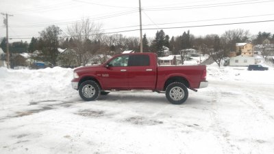

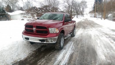

Superlift on '13 Ram 1500 Outdoorsman
4" Superlift with Bilstien shocks, Moto Metal 20" Havoc wheels wrapped in 35x12 Mickey Thompson Baja MTZ's 1.25" wheel spacers (due to rubbing).
