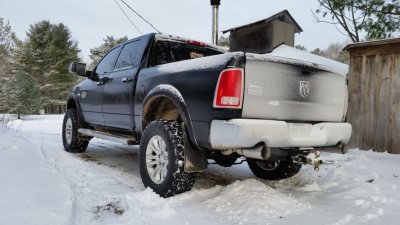

I have a 3" body lift and you can still adjust the exhaust tips up enough to make it look good.

I had my tips adjusted, then I added 5" tips to help fill out the holes. Looks unreal! I've attached a before and after pic. You'll also want gap guards.
My set up is a 2" front level, 1.5" rear spacer, 3" BL. 1.5" Bora adaptors with 35" duratracs
I actually got the idea from you haha. You're also why I asked about the exhaust. What kind of kit did you use? I usually try to not buy cheap eBay crap but isn't a body lift going to be the same regardless? I mean its just a spacer right? Or no lol?
Oh right on lol. I used a Performance Accessories 3" body lift. I'm not sure on other kits, I just looked at what other guys on this forum were using and went with that!
