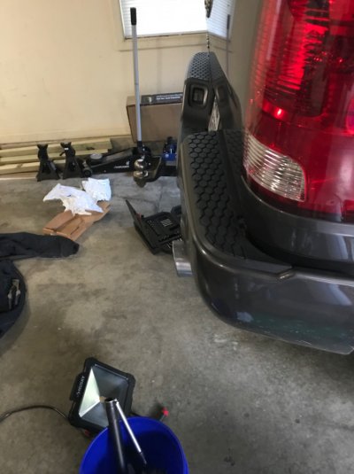

I saw RysRams post about 2 months ago about the Borla install and so I jumped on the bandwagon. Got the muffler from Nick and ordered all the clamps and extension pipe per RysRam and it’s been sitting in my garage for over a month.

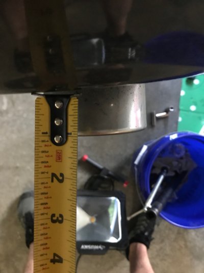

Install was pretty easy, I think I’m gonna take it back off again and shorten the extension pipe up a bit. I think my tips are sticking out a little too far. If anyone wants to measure I’d appreciate it.
So I bought a Borla Muffler part 400486 (bolt on), an 18 inch long extension pipe, two 2.25 clamps, one 3 inch clamp, and a 3 inch SS clamp. Old muffler came off alright. Sprayed PB on all the clamp bolts, bolted everything up, and now I’m gonna go for a spin.
Here are the pic of it installed.
Remember, if anyone wants to measure their tips like I did and let me know the dinension, I’d appreciate it.

Just cut 1” off the extension pipe. That will place your tips back where they should be.

Yeah, I just searched through the forums and looks like tips are usually flush. What sucks is that everything has to come off to cut the pipe...muffler, tail pipes, and all that. Oh well, lol.

Looks good. My tips are flush with the rear bumper.
Yeah, I needed my ext pipe to be 16 inches.
My old muffler had slots in the two outlets and the 2 tail pipes had a small metal tab on top, almost like it was to lock them in. So either I grind the tab down or take the ext pipe back off and cut to 16 to get that inch. I’ll probably go that route, it’ll drive me nuts

Yeah, I mentioned the alignment pins in my original thread. They need to be ground off to get enough of the tailpipe into the muffler outlets. The mid-pipe has an alignment pin too....it's right where the the 3" band clamp connects the extension pipe to the mid-pipe.
